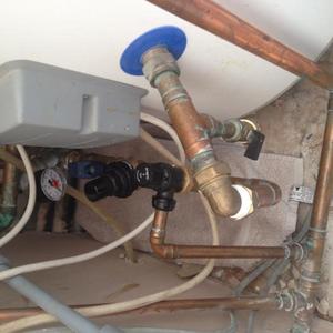

    I don't have a valve with a grey top- hopefully you can see my photos now. An you tell which of the valves pictured is the bypass valve? Both of the black valves (a 3 bar and an 8 bar valve) were replaced after the noise started, as was the blue stopcock.

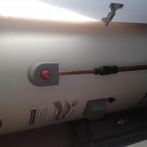

    TPR replaced 2 months before problems started.

    These valves were replaced after problem started (not the little black tap though).

    Thanks for your reply! It occurs fairly randomly, mostly between 12 and 2am, but it can happen at any time. I don't think it's ever started when the boiler is actually running for heating or hot water- though the sound doesn't instantly go away if the boiler is switched on. Last night, it...

    Hi All, I'd be very grateful for your thoughts on a problem we have had for a month, and which we have spent several £100s on, with no success. Despite visits from 3 plumbers/engineers, we cannot get rid of a loud screeching/groaning noise occuring in our plumbing, which seems to emanate...

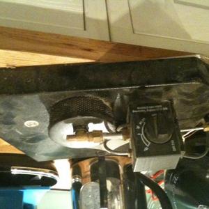

    A friend has just pointed out to me that I have the part upside down! He thinks that once installed by a RGI all I need in addition to what I already have is some fake coals/logs etc, and it should be fine, but he is not an expert! Any thoughts on whether anything else is needed...

    Thanks - good advice, though this part was never installed. It was sitting in a cupboard. What I want to be able to do is have all the parts I need in the house, then ask an RGI to come out and carry out all the checks and install the fire. At the moment I am obviously missing some bits and...

    Hi- Apologies if this is in the wrong forum. I recently bought a new house. The owners left us a "gas fire that just needs to be fitted". I will leave the actual installation to a professional, but I want to know what else I need to get (and where I might get it from). There should be...
