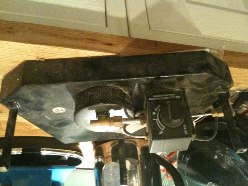

I recently bought a new house. The owners left us a "gas fire that just needs to be fitted". I will leave the actual installation to a professional, but I want to know what else I need to get (and where I might get it from).
There should be an image below: basically, I seem to have the base of a fire, with a place for the gas to go in, and a dial for switching the fire on and off and adjusting the flame.
What we want is a basic, simple gas fire, coal or wood effect - the bare minimum really. So what I need to know is -
what is the name of the part that I have?
what other parts do I need before I can ask someone on the gas safe register to install it for me?
where would I get those parts (and are they expensive?)
Many thanks indeed.

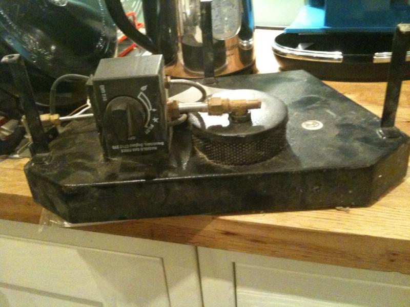

A friend has just pointed out to me that I have the part upside down!
He thinks that once installed by a RGI all I need in addition to what I already have is some fake coals/logs etc, and it should be fine, but he is not an expert! Any thoughts on whether anything else is needed?

What you have is a magiglo inset tray gas fire, with at least the coal set missing. You cannot just fit coals or logs randomly, you need the instruction book for the right parts and layout.
Your friend is wrong - in that you need the coals at the same time as an RGI, as he needs to test the fire in it's full working order.
Don't buy anything untiol you have spoken to an RGI, you may just be wasting cash.
More preferable to an RGI, though, would be a skip. These fires are totally inefficient compared to a a proper radiant or convector gas fire, and although we run a gas showroom, we rarely sell them, and only after telling custromers that they shouldn't buy one!
Magiglo went bust a couple of years ago, and were bought out by Burley of Oakham. If you telephoned with model and serial number, they would tell you if parts are avialable. 01572 756956.

Perhaps you are beginning to see that what you have is an incomplete gas fire mechanism with the coals missing!
Perhaps they bought it from Ebay for £10 and thought that it would make a greater increase to the price of then house?
Now hopefully you can see that its not a simple job to fit it. First its necessary to see if the coals are even still available now that the maker sold up or went into administration.
But before any gas fire can be installed, the fireplace dimensions need to be checked and the flue tested. It cannot be assumed that any old fireplace will be suitable!
