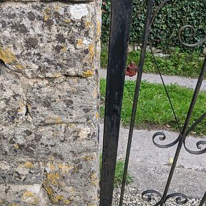

    Ah yes - the stud between post and wall would not be visible as the post would end up being next to it. Hadn't thought of using a nut then wood as a temporary way of get the post into exact position. Was just going to use a nut then cut off the remaining stud. Domed nut would be much better...
  2. S
    Sagged gate on metal posts
    I was worried about the post rusting through water ingress, rather than the new hardware. Hadn't thought of eye-bolt - yeah there is not enough room to bring in the top hinge by 20mm. Seems like bodging with resin/rod is a goer - need to pick the right spot into a reasonable size/sound...

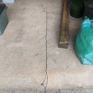

  3. S
    Tidying up garage floor on the cheap
    Thanks - I'll give that a go on a small patch. Shouldn't be too much of a disaster if it goes pear shaped as will be covered anyhow.
    Hi, Our garage floor is concrete, presumably set in separate pieces as has always been split into three bits that have moved apart over time. ~10mm gap between the pieces and one is ~10mm higher than the others. Seems stable though - been like this for > 10 years. I'd like to remedy slow...
    Hi, Our front gate has sagged such that it no longer closes - top is ~20mm closer than bottom, and spirit level suggests the movement is on the hinged post (not surprising due to the weight of the gate, though the latch post is bang up against a drystone wall). I think I'm gonna have to dig it...
