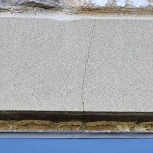

    Should I worry about this crack in a lintel?
    Thanks noseall, I guess that's good to know. I'm pretty sure this crack occurred as a result of pilling being performed in the field next to us where they are building lots of square houses as I've never noticed it before.
  19. M
    I noticed recently a crack in a long stone lintel above a large window on the ground floor of my house, which was built 24 years ago and I have lived in since new. As far as I can tell, it appears to go all the way through the lintel, but obviously I can really only see a small part of the...
