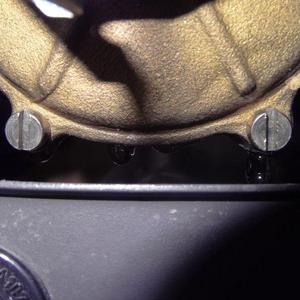

    Potterton Performa 24 leak from bottom of DHW PDV
    Fingers crossed; looks like a new diaphragm has done the trick - thanks!
  5. O
    Yep, deffo coming from there, and it's dripping a lot now again (even with HW off) - see pic. I last changed diaphragm about five years ago! Could it be caused by anything other than the diaphragm?
  6. Untitled
  7. Leak
    Leak
  8. O
    Ah i see. It's the front part (brass valve), with the microswitch.
  9. O
    Sorry, not sure what you mean. See fig. 83 (p. 44) here: http://www.potterton.co.uk/docs/Potterton_Performa_24_Eco_HE_Installation_and_Service_Instructions.pdf The water is leaking from the bottom of this unit. Does that make sense? In the past i've had water leak out of the hole where...
  10. O
    Hi guys The other day my boiler started leaking quite badly from the bottom of the DHW PDV. That is, water was almost pouring out for a short time. However water is now only dripping out occasionally. I thought it must be a seal of some sort, but, having opened it up, the only 'seal' i can see...
