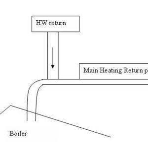

    Image attached (not fantastic quality). For info, shutting the bypass (gate valve) does stop the radiators getting hot. As for common return. The only thing that is common about it is the final few inches. It is the main reurn pipe from the heating circuit that enters the boiler and the...

    Yes, but problem pre-dates this. Regarding return connections. Return from cylinder tees into main return immediately before it enters the boiler.

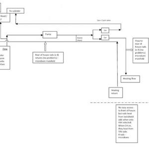

  7. A
    Motorised valve passing?
    Would the following symptoms suggest a passing motorised valve - heating side? HW on: rads heat up from return side. Path is via bypass (gate valve). Being summer (!) we shut off all the TRVs to save this unecessery heat and waste of fuel. When we do this, return is cold but the flow pipe...

    I am pretty sure. The pipes are above my head in a cellar. Four small bore returns from 4 radiators (at the point marked on the diagram). The 4 flows are just past the heating 2-port valve (again as marked). I can trace the ground floor ones (flow and return) to the radiators themselves and the...

    Thanks for that. Thing is, it is not those radiators that heat up with only the HW on!

    Is there a problem having some radiator returns (see first post diagram) between the bypass and the boiler on the main return?

    OK. dhw stat turned up. Bypass shut off. All TRVs fully open. radiators do not heat up.
