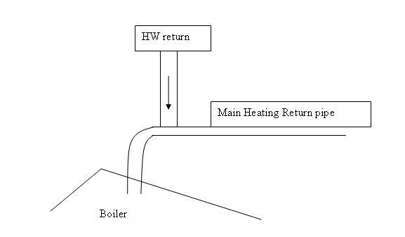

Image attached (not fantastic quality). For info, shutting the bypass (gate valve) does stop the radiators getting hot.
As for common return. The only thing that is common about it is the final few inches. It is the main reurn pipe from the heating circuit that enters the boiler and the return from the HW tees in just (i.e a few inches) before it enters.

As I said a classic case of reverse circulation, it cannot be anything else.
Unfortunately your drawing is missing all the important pipes.
Forget the cylinder for now, we need the htg flow and return pipes.
In the meantime shut that by-pass valve off and see if it makes any difference.

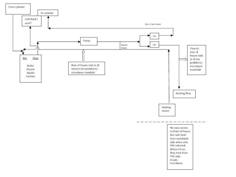

OK, The return pipe from the rear of the house is the wrong side of the by-pass valve.
Which opens the loop from the other circuit.
I cannot see why the inaccessible parts of the system are anything other than the flow pipe with microbore feeds to radiators, coming back as the return with the microbore returns from the radiators. What other configuration would lead to the problems? The cylinder is directly above the boiler at the rear of the house, well away from this part of the heating system. For info I have a cellar so the bits that I have drawn are totally visible.
The plumber we had in suggested closing the bypass which he did. This does stop the radiators heating on “HW only” but the boiler cut out. All was cold and the pilot was out. Boiler has pump overrun.
[OK, The return pipe from the rear of the house is the wrong side of the by-pass valve.]
The radiators at the rear of the house are not affected. Would you expect this? (NB: I’m a total layman so sorry if asking obvious questions!) Can you explain to a layman why in reverse circulation there is flow against a closed m/valve?
There is your answer.
You would need to move the bypass connection (on the return) to right before the boiler as the reverse circulation is coming from there. The microbore runs at the front of the house from the manifold may be shorter.

The return from the rear heating is the wrong side of the by-pass
Either move the return or the by-pass connection, or just swap them over if it's easier.
