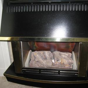

    Broken Glass on old fire and BBU.
    Thanks. I just managed to order the glass. A lot of places said that it is obsolete and that I had no chance. But I got the part number from Glow Worm and found some on line. £78 plus VAT plus P$P was the cheapest. http://www.discountedspares.co.uk/glowworm-424025-glass-panel-assembly-obs...

    Just a thought! When I fit the new glass by fastening the 4 clips. Is the glass just there to protect from the flames or does it need to be air tight or something to protect from carbon monoxide? Thanks.

    Hi, I have smashed the glass on my old back boilers fire! It is a Glow worm Co ordinate LFL fire with a back boiler. Is there anywhere I can get a replacement glass? can I get a piece cut to size? Also I have removed the broken pane of glass. it was held in by 4 clips. Am I allowed to do...
