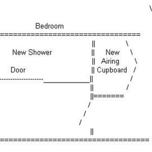

    Position of shower head.
    I am installing a shower into the gap between the end of the bath and the end wall, see http://www.diynot.com/diy/threads/shower-enclosure-at-the-end-of-the-bath.420457/#3264958. So the shower in plan looks like this:- +--------------------------------+...

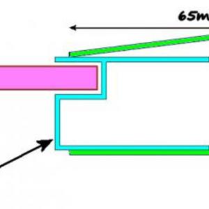

    Ahoer enclosure under sloping ceiling
    I knew from the outset that I'd have a challenge; well, that time has now arrived. I ripped out the old shower there were leaks in the ceiling below). I have installed a 1200 x 900 quadrant shower tray, and done the plumbing, and the walls are tiled. Everything works just fine. But she...

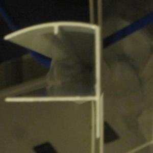

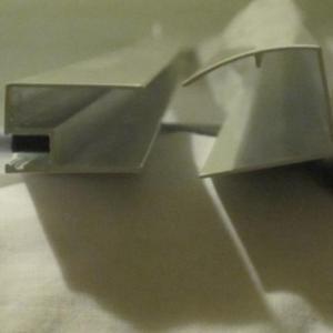

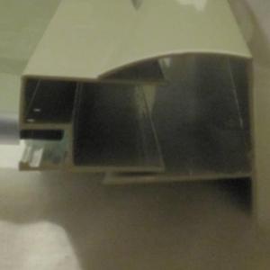

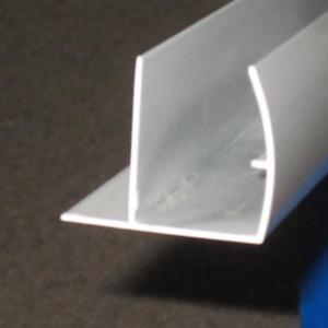

    Shower enclosure against a sloping ceiling
