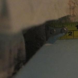

    Floor under shower tray
    Thanks, Adam. The two walls are not perpendicular - the angle is about 110 degrees, wider at the front. So I have cut away some of the brickwork so that the front edge of the shower tray touches the wall, while the rear edge is tucked under. The seal is Homelux Ultra Seal Pro. Here's...

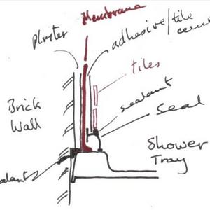

    Gap between shower tray & wall
    I have a challenge, for which I would be glad of your advice :- I took out the old shower because there was leakage which led to rotting floor joists. That's all sorted now. I have waterproof matting that I want to install next. I have plastic trim to go along the top of the tray, to...
