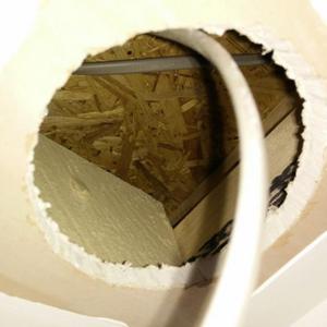

    Bathroom extractor venting into roof space
    Recently we had a loft extension, including a bathroom. Now winter is here we've noticed the ceiling extractor blows a cold gale in when the wind comes from the West, so I decided to find the vent outlet. Took the fan off and lo and behold - no ducting. They have left it venting into the roof...

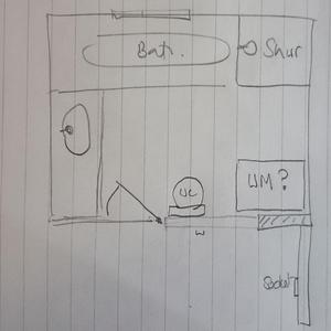

    Washing machine in bathroom
    I'm planning to install a washing machine in my bathroom. I believe it's building regs compliant but I wanted to check. I plan to use the socket outside the room to provide power (see picture). I'm unsure of the following and would really appreciate advice: 1. Do I need to enclose the...
