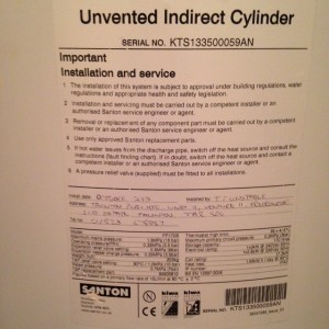

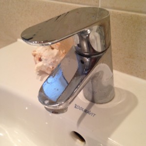

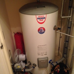

    Here is an image of the cylinder. I presume that as there is no cold water storage then all cold water outlets are fed directly from the mains ? I understand re unvented cylinders so won't be touching it but if its the taps then.... Presumably if they print their name on a tap then it is a...

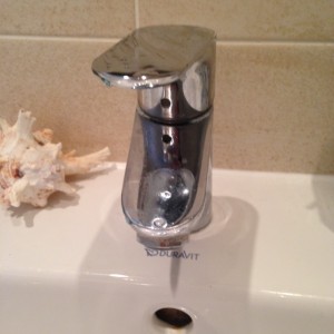

    Whoops. I hadn't seen the writing on the tap or visited. I just asked for some pictures. I am pretty sure it is an unvented cylinder. I'll get another picture then we'll know for sure. The house is a new build about 2 years old. andytw

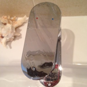

    Hi, Couple of questions. Firstly can someone identify the brand of mixer tap in the pictures please. Secondly has anyone had experience of selecting cold water but getting hot water instead. The water does eventually run cold. This is a new problem affecting 2 mixer taps in my son's house...
