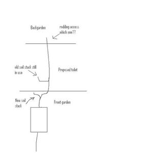

    Thanks hugh, Im not very happy with idea of no rodding access to be honest. Thats a new drain run with a new manhole. I had some come install it for me. Initailly my manhole was on the inside of garage right next to the gable end wall. I had it moved away from the gable as i may have had to...
  9. M
    Drainage question
    Does this help? > Should i place a rodding access into the soil stacks? > What kind of rodding access should i have in back garden? bearing in mind i need a gully there too for kitchen waste. > and also the bend at the front may be (haven't tried yet) a hindrance for rodding through...

    To get a better understand I already have rodding access at both sides of the run one manhole that i have is in the front drive way and another in the rear garden (rodding gully). The toilet drain will be connected into the center of the drain run and and taken horizontally 1 meter away to...

    Are you saying the manhole should go in the bathroom?
  14. M
    Drainage question
    Hope some one can help me with this. I'm building a ground floor toilet and need to connect the drain up to the main run. the drain line is going straight through the extension part of the house (directly below the ground i wish to make toilet room) can any one advise best way of doing...
