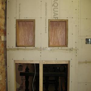

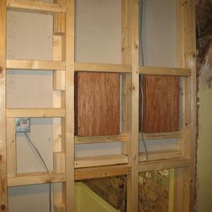

    Plasterboard or Backer boards
    Thanks for your reply Richard Re the wood V Aqua panel my take on it is this and i don’t mean to say you are wrong :oops: Whatever you use you are attaching it to wood just like you do on the floor so i just don’t see the issue. If i used aqua panel to make the boxes i still would have...
    Thanks all for your replies very helpful :D I called up Bal tech line and had a nice chat with David Spruce. He was very helpful and advised that making the revels out off plywood would not be an issue as i would be tanking the area anyway. So i have gone for Aqua boards and WPB 18mm...

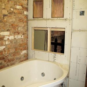

  13. P
    Right after a bit of help and advice please if i may, i have done a few searches but it is not clear cut. I am sorting out our bathroom ripped it all out and started from fresh, i have got a lot of good info from here and put it to good use so far so thank you all :) I am installing a...
