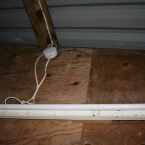

  16. C
    power trips in garage
    I have now sorted my lights issue all are now working: 1 faulty capacitor wiring was also a mess so have changed the unit. 2 water getting into the unit from condensation again replaced unit and re sited so no chance of condensation from metal roof. I still have no power to my sockets on...
  17. C
    hi in answer to the questions I eliminated the stable as everything works. Yes understand it didn't at one point so will check for loose cables etc.. no fuses have blown the main trip tripped, good point I will open up the two remaining sockets and check for loose connections. The...

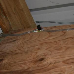

  19. C
    I have now taken some photos in the garage ( before I am shot down for shoddy work these are not my electrics all inherited ) yes should have re wired them in the summer but no time but great now a few days before Christmas http://www.diynot.com/network/cliff1010/albums/ you will see in...
