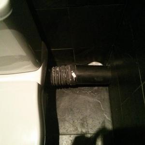

    Odd shower and sink drainage issue
    understood, will give it a bash!
  11. M
    Thanks kbdiy. To answer your questions: 1) Yes, the toilet flushes fine. 2) Yes, the basin pipe is the small one going down at about 45 degrees from left to right, joining the main stack towards the bottom of the photo. 3) I think I may have already used a drain snake...
  12. M
    Update – I kept the shower running after having plunged it so it drained smoothly, and tried the sink at the same time. It still didn’t drain properly, so I’m assuming the two issues are unrelated. I’ll have to get someone in to take up the shower/tiles to access the waste pipe, but does anyone...

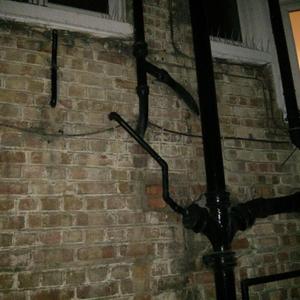

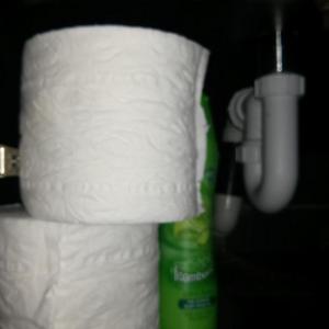

  13. M
    Ok, so took some photos. One is of the pipework beneath the sink. The second is the waste pipe from the toilet. The shower is out of picture to the left of the toilet, but presumably the drainage pipe from the shower joins this main waste pipe, as on the third photo from the outside, there's...

  17. M
    Understood, thanks. So to my previous point – if I’m having issues with both sink and shower (that exit the bathroom via different routes), the odds are that the sagging pipe would be on the outside of the building, rather than inside? Which would be a major bonus….. I’ll try and take some...
  18. M
    Thanks, kbdiy. I’m not at home but will take pictures tonight and post. Regarding Buck51’s comment on the sagging waste pipe – what I don’t understand is why plunging it would then allow it flow freely. Is it because at the end of the shower, there isn’t sufficient gradient, so the water...
  19. M
    Thank you Buck51. the sink is next to an external wall, so flows straight outside. the shower drain is partly runs under the floor of the bathroom before taking a different route out. given they are both affected, does this mean the problem of the waste pipe is outside? or will I have to take...
  20. M
    Hello all! I recently moved into a new (ground floor) flat and have a bizarre plumbing issue I was hoping someone might be able to shed some light on. The bathroom has a toilet, basin, shower and separate bath. The toilet seems to flush ok, the bath drains fine. The sink and the shower...
