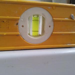

    Is my shower tray fault? Bump in middle of tray
    Hi all, I've bought a 900*900 slim profile shower tray. I was installing it over the weekend using a mini level to get it level across all four sides. When I placed a level on one of the sides I noticed it was rocking. This was the same on all the sides. If I push down on one side...
