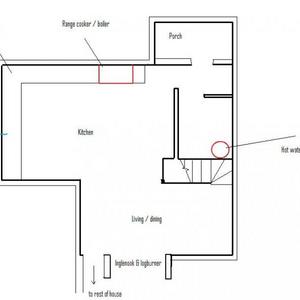

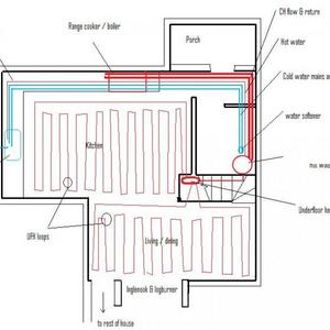

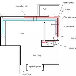

    DIY undefloor heating and first fix.... hmmmm..errr?
    Has anyone else done DIY underfloor? Any thoughts on this?
    As an enthusiastic DIY'er I am planning on having a go at my first fix plumbing. I havn't done a project as big as this before, but you have to start somewhere and I do have a competent plumbing 'mate' who is checking in on me every now and again to make sure I don't cock something up and is...

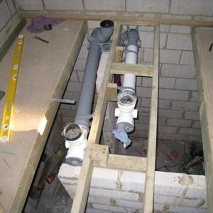

    Attaching a boss to orange soil pipe - solv. weld or strap?
    Have to make a connection to a short length of vertical orange soil pipe under the ground to take a 32mm pipe - would I use a strap on or solvent weld boss for this? Was going to use a 50mm boss with a pushfit reducer to 32mm. Any other way of doing this?

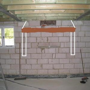

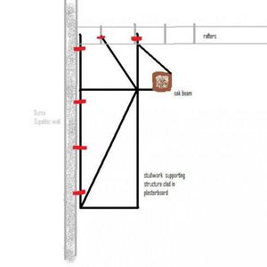

    Kitchen 'faux fireplace' - have I got the right idea here?
    Thanks for that - yours look lovely by the way, the cream kitchen with the red range is exactly the sort of look we are going for. So I will be OK using the joists to partly 'hang' the studwork? I hadn't planned on sitting the studs on the cabinets owing to the need to get the measurement from...
  18. L
    Hello all, be gentle as I am a newcomer to this scale of DIY! - we are currently in the midst of extending to include a new kitchen. Architect drew up the plans which include a nice surround around a 'feature' range cooker in the kitchen... all lovely. When the builders started building and we...
