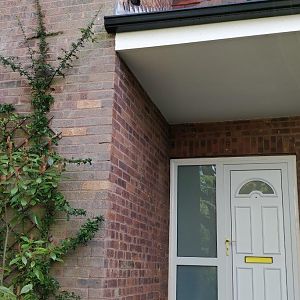

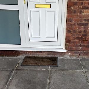

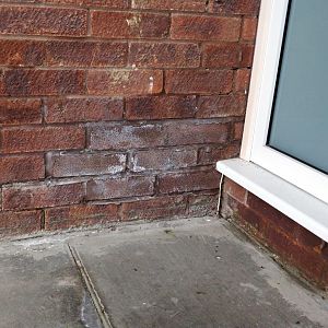

  5. R
    Water above DPM, not exposed to rain
    Hi - I am hoping somebody might be able to help me please. As you'll be able to see in the attached photos, I am getting water in brickwork above the DPM after heavy rain. The affected walls (to the left and right of my front door) are covered by a porch and it is not possible for rain water...

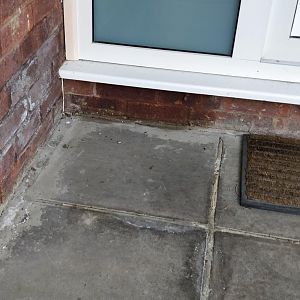

  13. R
    Water rising through damp course
    Thanks again John. The pointing on the flashing does look like its deteriorated and it would make sense as I know the cavity is clear, the damp course has been replace recently, there's no damp inside and the dampness only occurs in the rain. You've saved me a fortune in surveyors (fingers...
  14. R
    Please see the porch. The wall adjacent to the front door is becoming damp which happens to be below the flashing between the wall and porch tiles. I am fairly sure the wall is not getting splashed with rainwater. Many thanks.
  15. R
    Thanks John. I'm not at home but I guess that's possible. I'll add a picture tonight. The porch has a pitched / tiled roof with flashing into the brickwork.
  16. R
    Thanks John. The floors are solid and the area is covered. Also there is no damp on the inside wall. Thanks
  17. R
    Hello, When it rains heavily I get a damp external wall and I could do with some help please identifying the best way to resolve. The wall is under a porch so its not getting splashed. I have had the bricks removed and the cavity cleared. When the bricks were returned a new damp course was...
