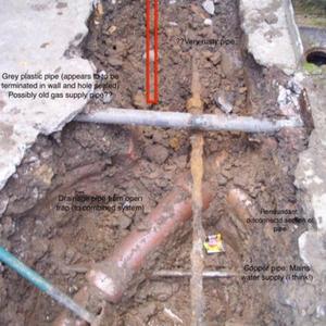

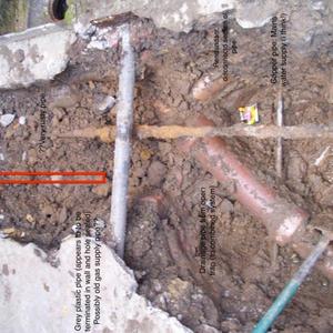

    Thanks again for your advice. I've been having another look and located both ends of the gas pipe which are totally disconnected. The rusty pipe has a 5mm hole in it and nothing leaking so that must be redundant and the copper water supply is 22mm so good news! I can crack on with the digging...

    thanks for the reply. I'm pretty sure the copper pipe is the current water supply as the entry point in the house is directly in line about 1m away. I hadn't looked at the shallow access chamber. Is there a definition of 'shallow' how many risers can i attach to it before i should be using a...

    Thanks for the replies. I think i've worked some of it out but presents a slight problem, so ideas welcome. I've attached a picture of the hole and pipes: Main Drain Copper Water Main Grey Plastic Pipe (old gas supply) Last year we had a suspected leak and they replaced our supply pipe from...

    thanks for the quick reply with suggestions. The electricity comes in above the front door on the other side of the house. The house is about 150yrs old so lots of time for things to be replaced.

    I've dug a hole to install a new inspection chamber for a new soil pipe i'm installing. However there's a couple of mystery pipes which are a bit in the way. One is quite close to the surface (approx 25mm) and very very rusty, the other is much deeper (approx 60mm) and doesn't look rusty so i'm...
