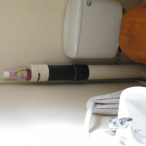

    What can I do with Air Admittance Valve?
    Thanks for your replies. I'm going to box the valve in this weekend and will leave the space under the pipe open as a vent. I'll post a picture when the work is done.
  10. B
    Well, that was a bit of a struggle. How I got the snap horizontal I don't know. Anyway, anyone can now see why I want to do something about this ugly brute of a pipe. Thanks for your help, denso13
    Hi, I've bought a house with a very small separate toilet. Alongside the throne is a three foot high tubular device with slots in the top. I can only assume that it is an air valve of some sort. It is about 4" diameter and very ugly and I'd like to get rid of it. Or, substitute...
