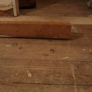

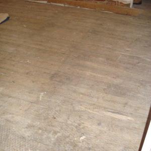

    Hi people, I plan to lay a solid floor into two adjoining rooms. They are only connected by a doorway. The rear of the house appears to have sunk by about 1" relative to the front and about 1" at the sides relative to itself. In other words there is a crown in the rear floor - or more of a...

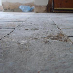

    Hi - I have a small section of floor that is screed. small = 1400 X 340 mm. The front of the screed is 23mm below the desired finish hight. The screed is not level and falls away evenly to a hight at the rear of 35mm below the desired finish hight. I wonder what the best way to affix a...

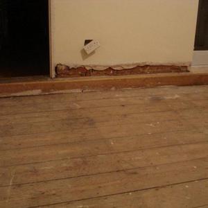

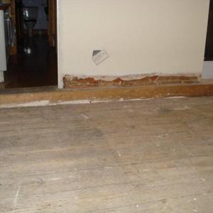

    unfortunately the concrete section is also not straight or level. That's why in the photo it's hard to see. It's a cap for the old masonry wall foundation underneath. When they were leveling it - they just drew it flush with the timbers each side - so it slopes right to left. I like the...
  17. U
    Streighten me out...

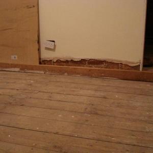

    I have a picture of a problem where my subfloor is not level. I want to lay a new oak floor perpendicular to the old floor. The floor to the right of the concrete is 10mm higher than the floor to the left of the concrete. This will create a weakness in the boards joining at that point. The...
  18. U
    Oak floor
    I have a picture of my problem where the subfloor is not level. I want to lay the new floor perpendicular to the old floor. The floor to the right of the concrete is 10mm higher than the floor to the left of the concrete. This will create a weakness in the boards joining at that point. The...
