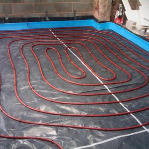

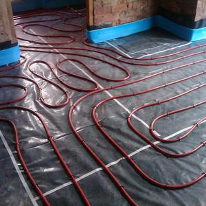

  14. J
    Undefloor heating - patterns
    I don't know if there is a problem - thats why I am asking the question :). There certainly is plenty of pipe but what I am concerned about is that areas of floor are covered with lot more pipe than other areas. If pipes are not uniformly spaced on the entire floor, is this going to cause...
  15. J
    So what should I do - rectify in places, leave it as is or start again? I am concious that I spent lot of effort and money in preparation for this underfloor heating and I want it to work right - not be unevenly heated, temperamental mess that we just avoid using . I clearly told plumber...
  16. J
    My plumber's installed underfloor heating pipes and my question is - how sensitive is the temperature difference in the floor area depending on pattern - pipe spacing. In the big square area, he's done the spiral pattern I asked him to do with roughly 20cm centres (Pic 1). In the smaller...
