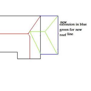

    New extension roof
    Hi woody, The plans didnt state anything other than the spars being 100 x 50 mm, When i had the plans done and submitted i should have seen this problem as the extension is slightly wider than the main width of the house, and with the roof running into and matching at the rear and the ridge...

    New extension roof
    Yes that may be an option, but on the plan which was passed it shows the ridge being lower on the extension! So i will ring the bloke who drew the plan and ask if moving it will be an issue. Have you ever compensated for an issue like this before? thanks

    New extension roof
    The front of the existing house roof runs and stops at a small gable end.

    New extension roof
    Yeah thats what i thought, didnt even realise this was a problem until a couple of weeks ago. when i got the steels in and started to bring the walls up i realised with the roof having to run in with the back and then meet the front of the extension there was an issue. should have been...

    New extension roof
    Hi everyone, I have built an extension and will be at wallplate next week, now my next job will be the roof construction, the issue is that the extension roof has to match the existing roof at the back and then the ridge will be lower than the existing. The front of the roof will then have...

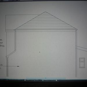

  8. roofline
    roofline
    house roof
