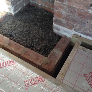

    Can I insulate under concrete hearth?
    Fill it with concrete it is then! I'm toying with the idea of losing my chimney stack from loft floor level upwards and just having a steel tube out through the roof, is this a good idea? How hot will the tube be and will it be ok just fixed to the loft floor joists and roof rafters? Also...
    Ok thanks, I was planning on filling in the hole with concrete and using that as the hearth and then laying tiles to finish. The bricks need another 2 courses laid to bring hearth above floor level and that will leave the hole at about 350mm deep, is this too deep for a single pour of concrete...
    I'm preparing the old fireplace for a wood burner and was just wondering if it would be ok / beneficial to fit 100m celotex under 100mm concrete slab? It's only a small area as pics show, my only concern I guess is the heat going down through the slab and affecting the insulation! Any advice...
