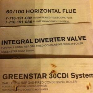

    HW & CH not working at the same time? (WB 30CDi)
    Cheers Stem, I dont remenber having one of those 3 port valves installed. Without that 3 port value installed, is that the reason why it doesn't do HW & CH at the same time? James
  2. B
    Hi, I have recently had a new boiler installed (July 2010) and have only just released that the boiler is running either the CH or HW function one at the time and not both together. I have got the DT20 timer, and have setup my program as follows: HW: M-F: 06:00-07:00 | 17:00-18:00...
