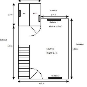

    Heat Loss Calculations
    D_hailsham thanks for the comprehensive response. I have managed to get my head round it. In answer to your questions: Does you boiler cycle a lot? Not a great deal Where is the room stat located? Bottom of the stairs (lounge) Do you have TRVs on the rads? No just upstairs bedrooms Do you...
    Galoka, things for the link I will have a look at it. Are you saying that I calculate the Heat Loss for the landing separately block, i.e. Length, width and Height of landing with one external wall. This would then be added to the lounge calculation, it give the overall amount. D_Hailsham...
    PrenticeBoyofDerry thanks for the info. So for external walls I would need to count up the U values of the Plaster Board (dot and dab) + breeze block + air gap with ALREFLEX insulation (i think that is what it is) + brick skin. Does that sound reasonable. There is no heating on the stairs...
    Hoping someone can help, I am trying to do some heat calculations for my Lounge, as I think that my current radiators are undersized for the size of the room and characteristics: I have looked at on-line calculators, but none seem to cover the case where a room is open to the stairs...
