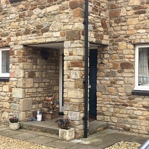

    Toughened glass porch
    Hi All, I was looking at installing a porch at my property. Ideally was looking at getting a ‘frameless’ look using 10mm toughened glass. The porch itself is structurally ‘there’ so a case of enclosing it (please see the image below) I’ve looked at getting a couple of quotes for getting this...
