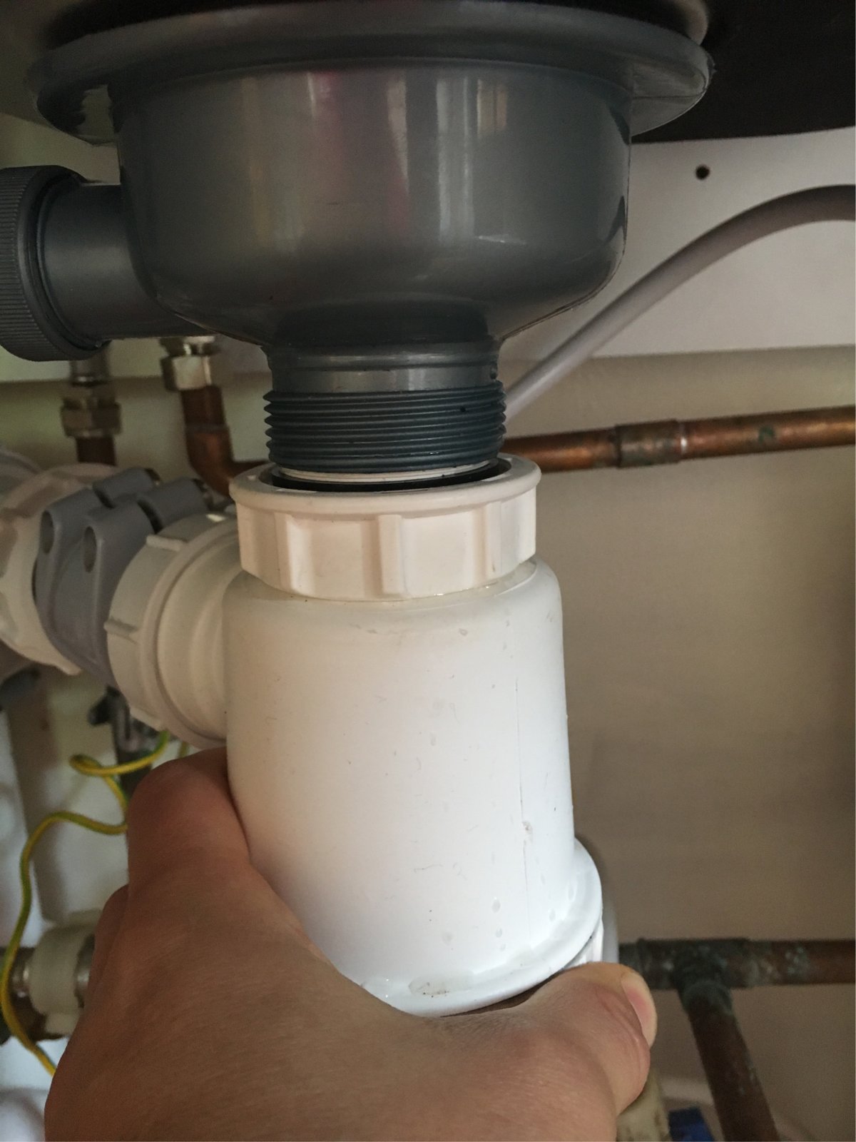

hi All,
We have a new sink and trying to connect the drain to the bottle trap, however the pipes will only seem to butt up?!
Not sure what the solution is to this one? Is there a seal for this? Should be 40mm
Is it an Ikea one? They're usually a non standard size so you have to use their waste kit
Many thanks for the reply, it's a Valle Albany sink with their waste fittings
Hi, tried pushing the trap up, the bottle trap just won't fit inside the sink outlet. The inside diameter of the sink outlet is petty much spot on 40mm.
If the nut will tighten onto the thread then just file/sand out the inside of the waste until the lip of the trap fits in and the seal is tight to the leading edge. Might need a bit of a good push. Had to do that on many of these cheaper sinks/wastes to make a standard trap fit in properly.
Thanks for the replies, having taken the parts out, had a much better look I independently came to a similar solution to Madrab, I chamfered the inside of the waste so that when I tightened the joint the bottle trap got pushed into position and seal made!
