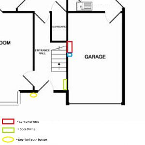

    Doorbell Transformer
    Doorbell setup by oakc posted 29 Jun 2016 at 1:46 AM Excuse the shoddy labelling but that's how easy it would be, i don't mind having wiring "on show" either in garage it's only the hallway i'll want to try have no wires visible. how easy is it to actually get a feed from CU? i don't think i...

  9. O
    Slightly off topic - if wiring into the CU is not an option, what is better solution loop in from ceiling rose on lighting circuit or from a fused spur on socket circuit? if go down fused spur switch route will there be enough room to put the transformer in the back box or can you do this? with...
  10. O
    Thanks EPL - i've already bitten the bullet and going to try the 18v AC transformer but will keep that one in mind if this doesn't work (although not a good photo, it looks like a rust bucket.. lol)
  11. O
    Yeah ive checked those and they only have 15v or 18v output
  12. O
    Yes, it's american but thought it would still work with the right transformer.. Silly me thinkin they would be 16v transformer would be easy to get in uk *smacks head* the only reason it needs to be 16V chime/transformer is the ring pro doorbell only supports 16v-24v ac transformer/chime. Which...
  13. O
    Yeah but thats for 120v input not 240V
  14. O
    thanks for the quick response! Being only 12v, won't it mean it'll be underpowered or atleast make it quiet? also the main reason is to install this doorbell (i've being given one for "testing/reviewing")...
  15. O
    Hi all, i was hoping you could help - i'm replacing wireless doorbell with wired and i've bought a doorbell chime the Honeywell RCW3501N wired door chime that requires a 16v 10av ac transformer but i can't for the life of me find one!! (for 240v/uk anyway) The closest i've found is a 18v 10av...
