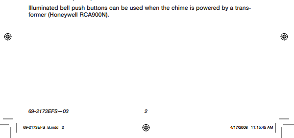

Hi all,
i was hoping you could help - i'm replacing wireless doorbell with wired and i've bought a doorbell chime the Honeywell RCW3501N wired door chime that requires a 16v 10av ac transformer but i can't for the life of me find one!! (for 240v/uk anyway)
The closest i've found is a 18v 10av transformer:
http://uk.rs-online.com/web/p/chassis-mounting-transformers/0504583/
will this work with this chime or is the volts difference within limitation as they are still both 10va rated or is it going to cause a problem? don't want to fry or shorten the chimes life expectancy lol.
Honeywell RCW3501N manual just says:
"Transformer powered - Wiring for standard/lighted push via a 16V 10VA transformer."
