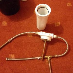

    Blocked heating pipe
    Morning all! Thought I'd post a quick update... The radiator is working fine, my entire system heats up in half the time, it's near-silent now and actually heats the house! I crafted some copper pipe onto the end of two hose pipes with hose-clips, and then attached these both to different...

    Central heating filters
    FWIW I went for the MB3 - installed today! I'm going to put a write-up in my related thread http://www.diynot.com/diy/threads/blocked-heating-pipe.413091/ Thanks every for your help... and Maccy D's al the time!! :lol: :lol: :lol:
