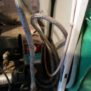

    Danesmoor 20/25 with Electro Inter B11 burner - bleed advice
    Bled, and now working. Radiators are warm, family is happy. Many thanks to everyone for your help! Jim
  11. J
    Here are the pics. The boiler enclosure prevents a full shot of the pump end face, but the three ports are definitely blanked off!

  16. J
    I have one of those on the end of the burner, but the ports are all blanks, there's nothing to undo. There are two pipes going into the boiler so I thought it might self-bleed, but I've reset it many times now and no joy.

  18. J
    Thanks John. So it sounds like I can slacken the flexi pipe to get the worst of the air out without having to spin up the burner on empty, then use the P port to finish the job, pressing the lockout button to get the burner spinning.
  19. J
    All, I ran out of oil at the weekend, have now had a delivery but boiler is in lockout, I assume it needs a bleed. It's a Danesmoor 20/25, using an Electro Oil Inter B11 burner. I've read countless threads on various forums where people have adjusted the pressure rather than the bleed...
