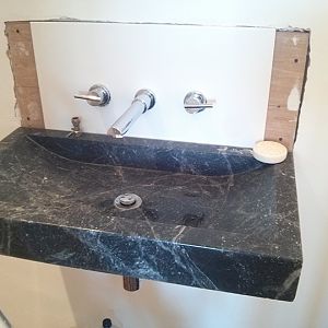

    Marble sink Issue-your views?
    Quite. I asked them and they said they were reduced because end of line stock because too many were delivered with faults/cracks.
  2. C
    It was approx £200 after price reduction. If its not fit for purpose then it shouldn't be sold really, irrespective of price. I am reluctant to divulge the name of this large stone and marble outlet until I hear their side. (Libel etc) Maybe I have made a mistake fitting it...but I really don't...
  3. C
    Thanks. I know marble doesn't like acids etc. My feeling though is that the small amount round the plug isn't the concern. Its the larger pool that 'sits' in the sink that doesn't even get near to the waste hole. I may go to the shop tomorrow and ask a few questions....
  4. C
    Thanks again. I think a seller like this one which i a very expensive and large one would care about the standard of their products and have consequently withdrawn these sinks. The question I am asking myself and others is a sink unfit for purpose, as you rightly say, if it doesn't adequately...
  5. C
    Thanks 'oldbuffer'. 1.Yes all level..flex of rods slightly forward but can easily correct and have supported it to text flow and no difference. If its flat it won't. 2. Shim it-not sure what you mean in this respect? 3. yes, agreed re waste BUT it should drain all except tiny bit round waste...
  6. C
    Flat bed will not drain is my belief. How can it? Shower trays etc have slight degree of fall and are designed to drain. Dy definition (sort of) a sink should drain. You don't expect to have to mop up after use! Also noticed cuts had been made underneath as if it had been perhaps fixed and...
  7. C
    Yes I have installed it properly-which was a major task as it is suspended on metal rods, sunk into inner and outer walls-worked with technical at Rawplug to obtain best solution. The sink is flat and drains in the centre-unlike a Belfast sink which drains in the corner and has a built in...

    Marble sink design flawed?
  11. C
    Hi, I have just installed an expensive end of line marble sink from a major high end marble and stone supplier. Sink looks good, BUT, it doesn't drain properly. It has a wide flat bottom that has no camber and therefore it won't fully empty and leaves a considerable amount of water. I asked why...
