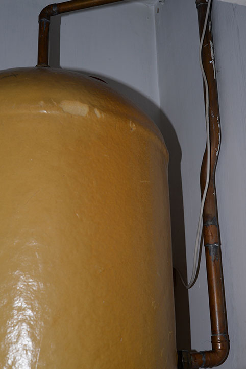

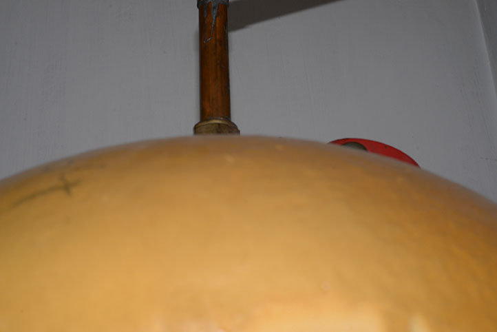

Couple of pics would help. If you have a flange, are there 2 pipes coming out of the top of the HW cylinder connection? One heading out the side of the connection the other out the top?
Dedicated feeds for the pump is ideal & a large enough Cold Cistern and HW Cylinder to feed 2 showers if pumped. Expect a drop in pressure if the other shower is used at the same time. Make sure you bleed the system properly.
One pipe only out of the top. One out of the side, which I am assuming was added to supply the showers. I can ring the tech line of. Tr are times when you wish you had left things well alone...
Nope, the pipe out the top looks like an ordinary supply and vent for your whole hot water system. You need to add a flange to the cylinder that has a tube that dips into the hot water to avoid drawing in air bubbles.
You need a Surrey/Warwick(x)/York flange or a separate tapping included as part of the cylinder to give a dedicated air free supply.
Yes, what I thought, unfortunately. What about the one out of the side though? Its a hot pipe. I thought it may supply shower hot supply?
And I need to take a cold supply directly from Cold tank...

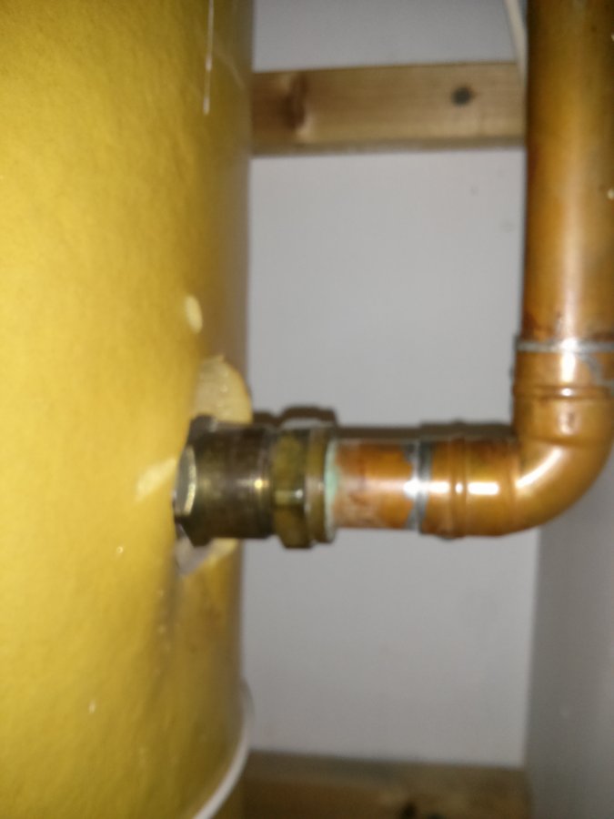

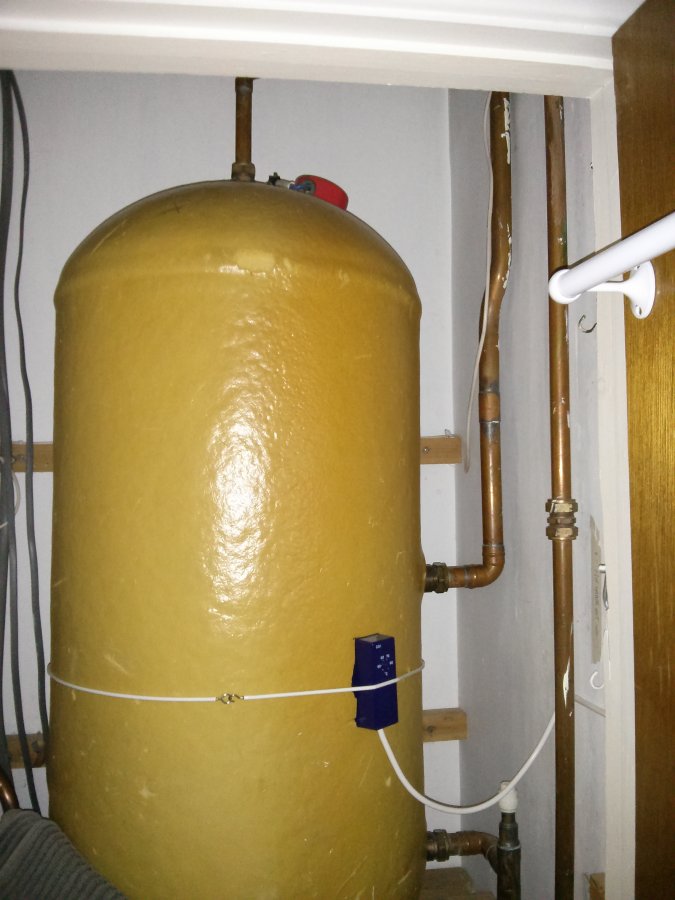

How is your water heated? immersion or through coil in cylinder? Photo of the whole cylinder and connections would be useful! Mainly one of the side outlet (Essex flange) that you think feeds the shower!
I wouldn't usually expect to see a flange down that low, that could be the feed/return for the coil inside the cylinder that heats the water. As Dilalio mentions a wider look at the cylinder and its pipework would help.

More shots but I am sure your right...its not dedicated shower outlet.
Those two connections are to the coil inside the cylinder and not for shower feed.
You'd be best of getting a Surrey flange which will be easier to install and means you won't have to drain cylinder so much and drill into it!
Any of the top fitting flanges will suit you, Surrey (Salamanders type) /Warwick(X)/York. If taking a dedicated feed from the cold, as far away as possible form the current feed in the cistern and if running 2 showers simultaneously, pump size dependent, then you may want to consider a 28mm feed to the HW cylinder and cold feed. Cold cistern size is also worth a thought, again depends on how the showers will be used.
