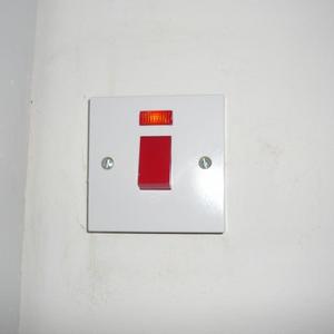

  5. P
    Wall Switch - Red Light Indicator
    I just installed a new switch for the electric shower and the red light indicator in permanently on, even when the switch is in the off position. Checked wiring and it seems fine. Maybe it's normal with this particular switch, can't see a make on the casing. Can anyone confirm that it is normal...

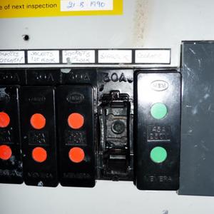

    Redring electric shower - fuse keeps blowing
    Attached are a couple of photos of the fuse carrier for the electric shower circuit.......

  14. Fuse Carrier - Electric Shower

  18. P
    I have a redring electric shower which blows the 30amp fuse everytime its used. Just started to do this over the past few days. Seems to last a bit longer if the shower water temperature is kept a bit lower. Have looked inside and wiring, etc. appears ok. See pictures. Grateful for any advice on...
