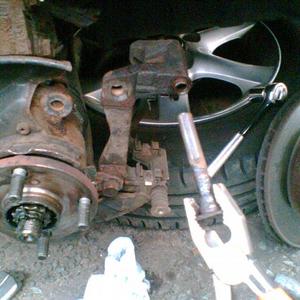

    toyota corolla '99 brake caliper problem
    Just thought I'd post back and let people know that I managed to get the pin out. I used my brain (I didn't have a vice so I improvised), lots of WD40, brut force and a plier. :) I found that it is a different pin to the other three... so I'll have to go to a backstreet scrapyard for...
    Ok, I had another go tonight and managed to get the rubber gaiter prized back and scraped away as much rust as possible. I really can't understand how this rust has managed to build up when there is a rubber gaiter on and no sign of fault on the rubber gaiter. :shock: Anyway, below...
  14. Caliper mounting bracket 4
    Rubber gaiter prized right back, doused with WD40 and then scraped as much rust away as possible.
  15. Caliper mounting bracket 3
    Rubber gaiter prized back to reveal rust buildup underneath.
  16. J
    Thanks guys, I'll see what I can get done. For a moment I thought I'd have to get the whole thing new from the stealers. Thanks again :)
  17. J
    Today, I attempted replacing both discs and pads on my car today. All was going well until I found that I couldn't put my caliper back on to the caliper mounting bracket. There is a caliper guide pin at both the top and bottom of the caliper mounting bracket. The top one springs in and out...
  18. Caliper mounting bracket 2
    Caliper mounting bracket with top caliper guide pin squeezed in.
  19. Caliper mounting bracket 1
    Caliper mounting bracket held against the brake disc with top caliper guide pin squeezed in.
