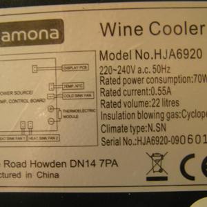

    not too impressed with appliances - have a wine coolerfrom howdens that stopped cooling - just out of warranty aswell ! :(
