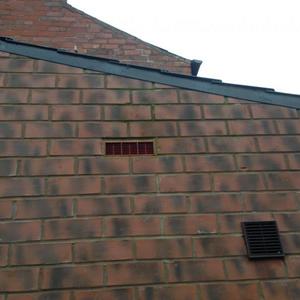

    green moss on brick work
    I'm happy to treat it/ clean it now and again as long as I know it is not causing any long term damage etc. is a just a 'chalk it up to experience' and get cleaning every year job?
    Ok. That's good to know. Do I need to get the roof re-done, or just treat the moss regularly? Is roof re-doing over-kill or sensible in the long run? Thanks for your advice mate
    The lower vent is the extractor fan from the cooker. The vent in question is the higher one. There is another air vent slightly higher and to the left just out of shot. The wall is pretty much east facing / maybe east, north, east Thanks for your help

  15. S
    is it preventable? The way the wall faces means it gets no direct sun - is this something to do with it? Should I add that the air bricks are venting the roof space. They are not in the damp proof area?
  16. S
    Noticed this morning after being in garden for first time in a while (due to winter) that our new extension (2 years in April) has got a bit of white efflorescene on some of the bricks, which is fine I understand. Have also noticed that just above an air brick/vent there is green moss...
