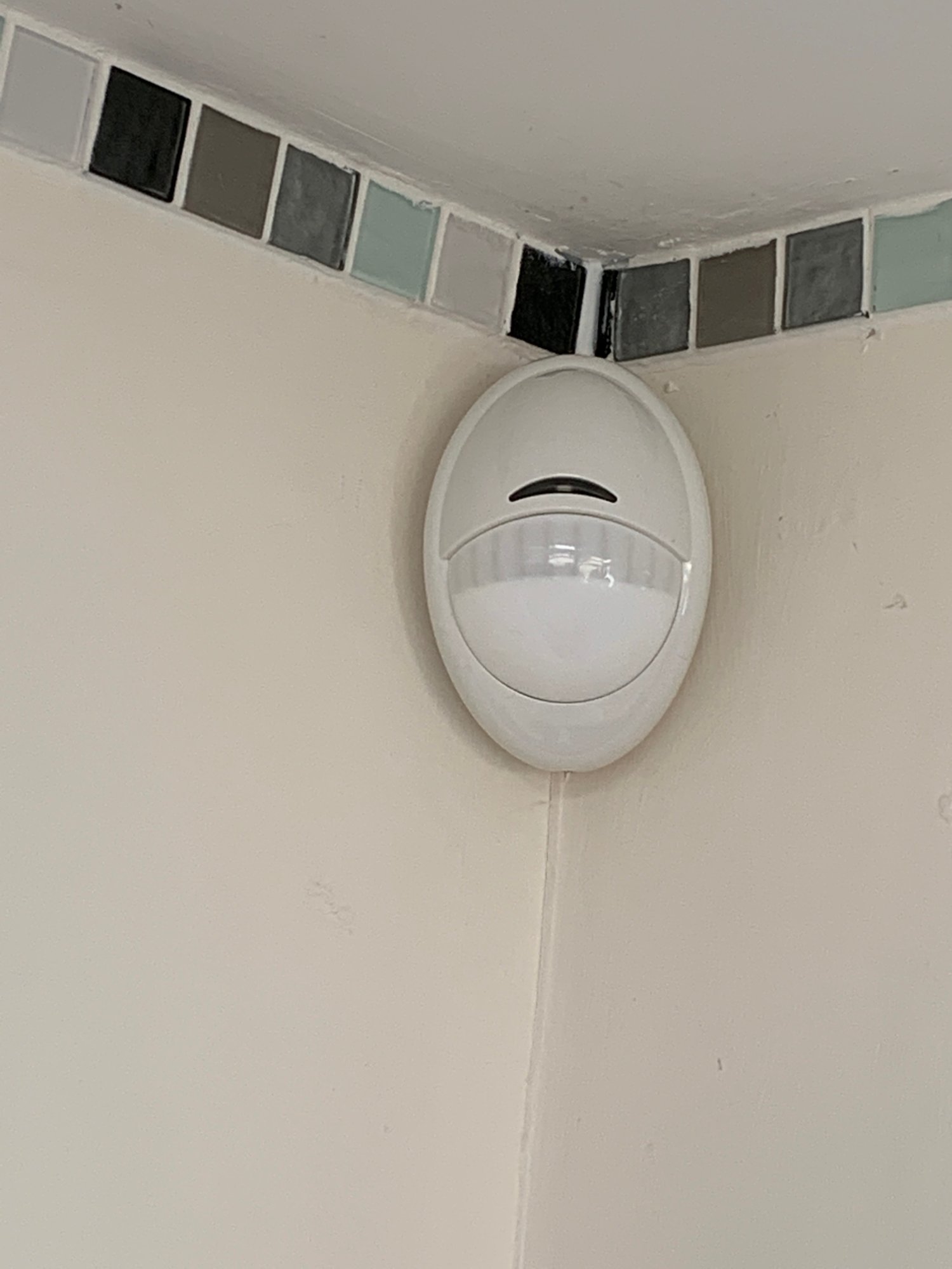

Hi,
I'm hoping someone can help. The room sensors on my alarm appear to not be working. I replaced the battery on the outdoor siren today and decided to do a walk test (haven't done one in ages).
The sensors registered, with the beep on the alarm but very intermittently. E.g I had to move around a lot to get them to pick me up. I could walk through a couple of the rooms and nothing!
I took the fascias of each one and the tamper alarms activated for each one and rang the phones. When I replaced the fascias one of the sensors worked properly on the walk test and beeped lots, flashed the red light and had a good room coverage, but the other two didn't register at all.
I performed another walk test a couple of hours later and none of the sensors registered?
Any ideas? I guess the wifi signal is ok if the tamper alarm worked for each one. Dodgy sensors?
Any help greatly received
Thank you
Sam

I will test again today, however I did walk tests yesterday, hours apart, and also on another occasion entered the house when the alarm was armed and the sensors didn't pick me up. The lounge one, after I took the fascia off, worked on one walk test how I remember them all working when first installed e.g. I walked the edges of the room and it picked me up many times, but the other two I moved around in the room and nothing - no happy sound at all.
On the next walk test a few hours later, the lounge didn't register me once. The other two room sensors still didn't register me at all.
I'll have another go today and post back. Thanks
Update.
So I set the alarm. Sat outside for 5 mins and then walked in through the conservatory door. That sensor picked me up two steps in and the alarm set off. I then re-set and hid around the corner in the kitchen for 5 mins just out of sight of the sensor. I walked around the corner and the alarm went off. I did the same process in the lounge and that sensor register me and the alarm went off.
So the three sensors appear to be working in that sense. But I am unclear why they are unresponsive or very intermittent during the walk test?

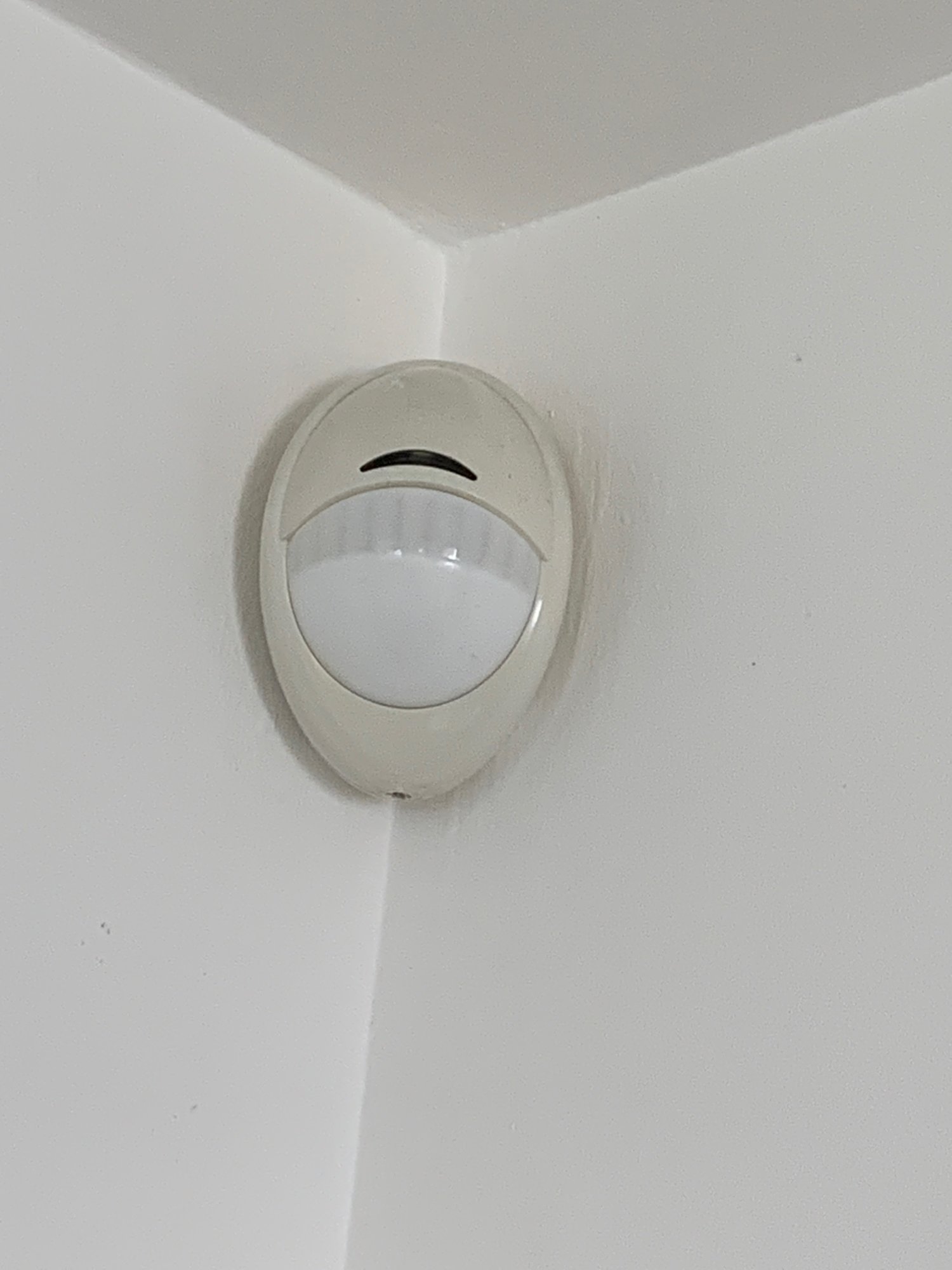

I'm uploading the photos. One is two years old and the others are approx 9 years old
Any advice greatly received.
Sam
They are the pet sensor version.
Not uncommon for visionic lenses to start to break down due to age.The lens seems to make the sensors become very poor on movement pick up.
As secure says the sensors go into sleep mode for a few minutes.
Best way to check system is set the alarm and trigger the device you want to check.
We have also had issues with visionic lens and no long install any visionic equipment.
Never installed Visonic just don’t rate them enough to install them, maintained a few and to be fair had no real issues when walk testing but I ain’t exactly small moving object.
petwise sensors are not something we recommend full stop the design is to stop picking up below a certain height.
hard to be certain as to why the walk test didn’t work when compared to them activating when the alarm was set. Not going to be able to get enough information to be certain on that I suspect.
WRT to what next, your system works within limitation and when it counted.
however maybe you should look at replacing it in the future with something else and avoid petwise/ friendly detectors where possible, unfortunate most wireless kits come with them as standard.
on the visonic pirs can you not remove the mask at the bottom to improve detection?
