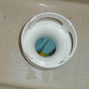

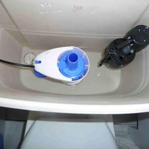

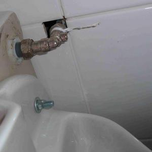

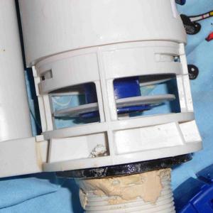

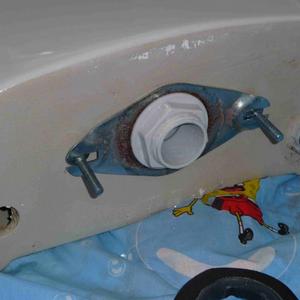

    Flush doesn't always stop.
    Well, I think it will be better than the one I took out! (Which isn't saying much). Two years time, I could be doing it all again. Thanks for listening.
  3. W
    I took the flush valve out, unfortunately it was a sealed unit so just had to replace it. The new one is a 'Torbeck Variflush Drop Valve' which as you say twists and separates, so in future I won't need to take the cistern off. Whether spare parts are available I don't know. Anyone looking...

  11. W
    I'm still trying to find out the make of the unit, and how it comes apart without removing the whole thing. I have a horrible feeling i'm going to have to replace the whole unit, which means taking the cistern off! Hey hum.
  12. W
    I'm going to take a look this weekend, so I will let you know what I find. I might even take some pictures. It seems to me that sometimes good ideas and innovations lack quality in components and construction. Martin
  13. W
    Thanks for that, I will give try giving it a clean.
  14. W
    Hi, I have a fairly modern flush unit, the type that is connected by a cable to a flush button on the top of the cistern lid, and the overflow goes into the bowl. Every now and again the flush doesn't stop. I have noticed that when this happens the central column in the flush unit doesn't go...
