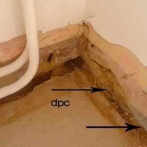

    Damp floor and corners
    Sorry, you cant see the dpc very well but it is there (see pic) and is compete, there is no damp above it, all the damp is where the floor joins the wall below the dpc. cheers

  7. G
    there is a damp course in the wall, but not between the wall and slab, there is a slight gap where the slab ends but no DPM extending over it. I am having to use board because I am flooring right through to a kitchen that is a slightly different height (the kitchen floor has been re screeded...
  8. G
    I have just lifted some laminate floor from my dining room and underneath are some lino tiles. There is mould on top of the tiles and damp patches around the floor/wall junction (see pic) where the mortar is crumbling away, this does not go above the damp course. and all the walls are dry. I...
