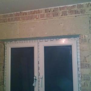

    Preventing cracks on lintel
    Hi all, just doing a little bit of renovation. I have had cracks in the plaster going from the corner lintel window reveal up. I got the plaster (render) off, the lintel is kind of a monster and it looks not very well supported on the brickwork, only sitting on pack. I believe this coursed...
