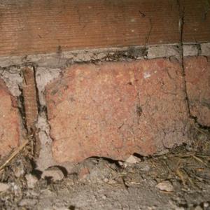

    I'm doing a loft insulation project and looking at the eaves to ensure insulation and ventilation. My ideal is to join ceiling insulation (cold loft) onto CWI, or near as possible. However, to do this I have to find the CWI, and I'm coming up blank atm! The eaves are extremely difficult to...

    This is the timber in the above picture. What masonry is this sitting on, and why is it there?

    Note the timber running along the eaves, from the first rafter in (see next image). Is that the outer leaf on the right? What about the masonry below that the timber is running along?
