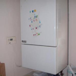

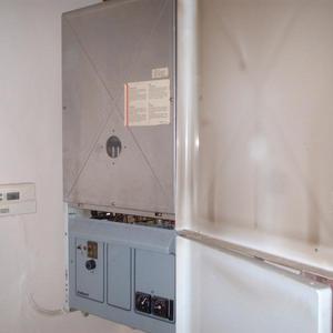

    Cant identify this valliant boiler...
    Hi, I have made you as a friend and sent you a message? did you recieve it?
    Yes, the cycle time is around 7, 8-10 mins, bit strange really, but when it goes cold its freezing!, your quite welcome to tell me about the combustion details, only its technically illegal for me to act on your information. on another note, if it was the heat exchanger ( HX ) wouldnt it just...
    Hi, thankjs for your replies, does anyone know where to download the manual, I have searched everywhere, I have a hot water problem with this boiler, it runs fine for around 10 mins and then goes cold for some reason, although if you wait another 10 mins, it will actually pick up heat again, not...
    Hi, ca anyone suggest the model number to this boilder, we dont have the manual and there are no markings?
