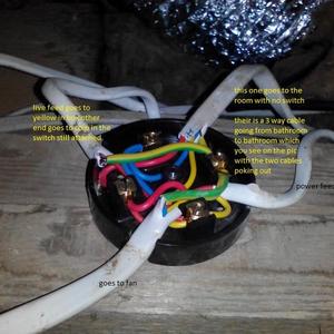

  7. J
    2 way bathroom switch`s
    i think the safest way to deal with this is to open up the spur and see what is coming out of there instead of guessing . i think the live is supplied via the 2 core and the neutral and switching circuit is via the 3 core. until i open up the spur this is all guessing. as the new...
  8. J
    sorry for late reply there are two cable into the pull cord , 3 core red yellow blue and a 2 core with the neutral cut off so only the live being used i think that is where the power comes in and the other end of the 3 core is where the neutral is coming from the switched spur.
  9. J
    i think so yes
  10. J
    correct seperate pull cord for the light switch
  11. J
    hi all bathroom fitter removed one of the pull cords before he left and now i need to reinstate the switch`s . both switch`s had neon indicators so i assume there is a neutral in the circuit. ? posted a couple of pics , for you . basically each switch in either bathroom could turn...
