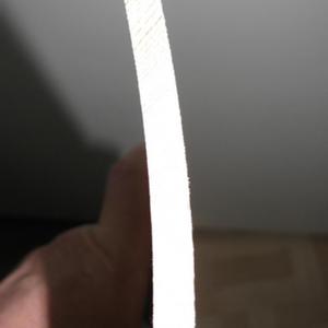

    Cupped Cladding
    Left boards stacked flat over Christmas and half of them are now cupped. I've restacked them in a criss cross fashion bow side up hoping they'll straighten themselves out, will this work or are they unuseable ?.
