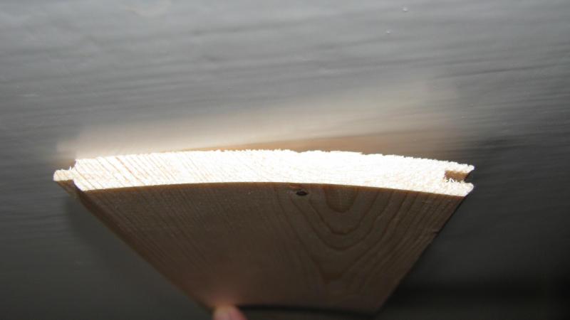

Left boards stacked flat over Christmas and half of them are now cupped.
I've restacked them in a criss cross fashion bow side up hoping they'll straighten themselves out, will this work or are they unuseable ?.

They're for indoors Deluks, instructions advised to leave for a minimum of 72 hours before fixing, ok i've left them a lot longer than that, about 2 weeks lol, but i'm wondering if i should have fixed them straight away because they were ok when i bought them.
room is just normal temperature, not hot. so it's a gamble then ? just wonder if i'm wasting time, any idea how long it'll take if they are going to straighten out ?
how much have they cupped ??

i assume its 88x9mm txg "V" groove pine
i personally think you may get somewhere between 10 and 25% success
how many have cupped ??
It's about 5mm out, doesn't sound a lot but they won't pull into place without cracking down the middle.
Managed to get a couple on that weren't quite so bad but you can still feel the cup in the middle.
I've got 45 1metre lengths like this, they were 3mtrs but i cut them down to size when i bought them.

That amount of warp suggest they have dried significantly, and that maybe they were only dried to about 13-19% moisture content (external use), instead of around 9-13% for internal use.

They have dried too quickly on one side. It's either the cut of the plank, or how they were stored
Damp them and the re-stack. Or put them outside, but under cover for a few days, and then bring them back in, but don't put them in a really dry or hot place

The sort of cladding that Wickes and the other sheds sell, is usually made of timber that's fast grown (so has a very open grain structure) They generally sell crap timber products at the best of times.

If you had a moisture meter it would really help, I would say fix them straight away, double nails on the board width.
I'd almost be tempted to say fit them tight, so that when they shrink they don't end up disengaging at the tongue, but that makes the assumption that they are to wet.
I didn't appreciate that they are only 8mm, makes them very prone to cupping if the moisture content isn't just right.
I think J J has got to the red meat of this,I think also the the width to thickness ratio is pushing at the bouneries for this type of timber, For the fixing I would glue them on with PVA and dovetail nail them, I know this goes against the technology of boarding but because the wood is so thin and pithy there will very little nail holdingf ability, I would just hope for the best because when the central heating gets hold of it it's going to go toasty so fix then leave it to settel in before painting
