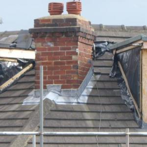

    New Roof Flashing
    Ah, i see! So are the soakers underneath the chase flashing or do you not need then with chase flashing?

    New Roof Flashing
    What are the pro's and con's of chase flashing and stepped flashing? Also, why do some chimneys have the side flashing under the tiles and some over it? Surely if it's ove then it won't be sealing the joint where the chimney meets the roof as its meant to do. It will be sealing where the...

    New Roof Flashing
    Hi guys, I was thinking of getting my roof renewed and the roofer doing my neighbours is going to give me a quote. The way he's done my neighbours chimney flashing doesn't appear to be correct and i would like your opinion on whether i should stay clear of this guy. He doesn't appear...
