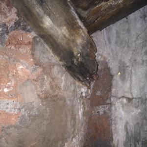

    Uploaded some pics. First is the roof from outside so you can see type of tiles and the lead thingy (flshing?) Then are a series of pics to show the brickwork in the attic and the damaged beam. Any advice on repairing the brickwork etc much appreciated. The leak is miimal and seems...

    Will upload some photos when I get home tonight (might be tomorrow). The roof appears to have moved maybe 2cm in the area where the beam has rotted. Good news (I think) is that all the other beams away from the walls are solid and no leaks. It looks to me like the broken beam may be...

    Another part to this question. Just been told that I could easily repair the damaged bricks and mortar myself 1 brick at a time. However, no idea what kind of brick to use. The advice so far is.... 1. Get a roofer in, to fix the leak and broken beam. 2. Replace brickwork...

    Hi all, Just had the loft decked out at the cost of £1000. I moved into the house last year, the previous owner having done a refurb. Part of this was a new roof. Now that I can access the loft, I was shocked to find a slight leak at eaither end of the roof (mid terrace) where it meets...
